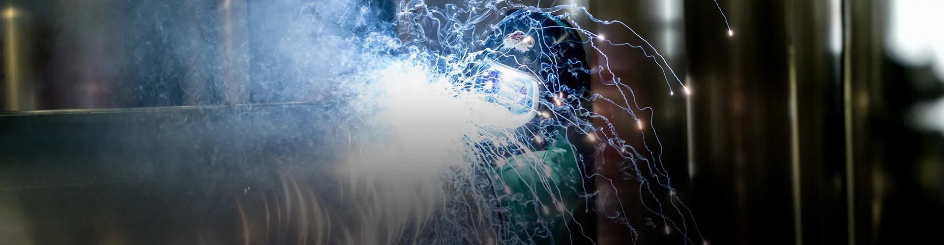

Our tour begins where flat aluminum stock is pre-rolled into cylindrical pontoon chambers. The material is available in multiple thicknesses, with the selected gauge depending on the boat’s performance package. Two-tube, triple-tube, and high-performance elliptical packages use thicker gauges to support larger motors. Once formed, each chamber moves to robotic welding, where the top seam is stitch welded with precise, consistent penetration to ensure strength and durability.
After the top seam is complete, each chamber receives a barcode identifying how it will be assembled into a specific tube for a specific boat. Baffles are then welded into each chamber to add structural strength and maintain integrity in rough water. The nose cone is installed to enhance performance, allowing the boat to cut through waves smoothly for a better ride when towing skiers or tubers.

Each chamber includes a coupling that allows for individual pressure testing. Every chamber is tested two to three times to ensure there are no leaks before moving to final assembly. To attach the deck to the tubes, saddle brackets—also known as M brackets—are welded into place. Their wide base distributes impact evenly across the tube, preventing deformation in rough water. Precision jigs ensure each bracket is welded to exact specifications, allowing for accurate replacements years down the road if needed.
A 10-kilowatt laser cutter precisely shapes components at high speeds, allowing Bennington to control quality and lead times in-house. Precision bending machines ensure every part meets exact specifications. The center tube forms the transom where the motor is mounted, and its heavy-duty construction and high-penetration welds ensure reliable performance in demanding conditions. Below, performance foils help the boat maintain control through turns, improving handling for skiing, tubing, and high-speed cruising.
