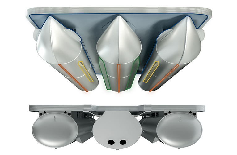

A - Lifting Strakes B - Keels C - Under Deck Wave Shield D - Performance Foils

ESP is the top of the line performance package for boats with 8' 6" beams. Boats equipped with this package benefit from enhanced stability and water displacement with quick planing and handling characteristics that rival a fiberglass sport boat. Designed for high horsepower applications, ESP is optional on outboard models and comes standard on all I/O models. It includes two 25" diameter outer pontoons with performance foils, splash fins, and .100 gauge aluminum, a patented 32" Elliptical center pontoon with lifting strakes and an under deck wave shield. The Power-assist steering option and a center fuel tank upgrade is recommended for boats equipped with engines rated at 200 hp or greater and is required on full windscreen models. Check with your local dealer for current maximum engine hp certifications.

The SPS and SPS+ hulls offer handling and performance characteristics similar to ESP in a lighter, more affordable package. SPS is designed for engines 200 hp or less and SPS+ for higher hp applications. Both SPS packages include 3 full-length 25" diameter pontoons, lifting strakes on the center pontoon, performance foils on the inside of the outer pontoons, solid round keels, under deck wave shield, SeaStar hydraulic steering, and a 32-gallon transom fuel tank on select models. Check with your local dealer for current engine hp certifications.

Bennington's exclusive Elliptical Pontoons combined with lifting strakes, performance foils, solid round keels, and an under deck wave shield offer incredible two-tube performance. Each elliptical pontoon adds over 1,000 lbs. of additional buoyancy, allowing the boat to sit higher and run faster. These pontoons increase deck stability both fore and aft as well as side to side. Available as a Freshwater or Saltwater package. Saltwater package includes saltwater anodes and sealed lifting strakes/performance foils. Check with your local dealer for current maximum engine hp certifications.

Reinforced guides placed at the bottom of the tube to protect it in shallow water and improve tracking while underway. Optional solid keels are recommended for use in saltwater.
Similar to a wing of a plane, these are placed on the bottom side of the tubes to provide hydrodynamic lift. Improved acceleration, top speed, and stability are added benefits. SPS, ESP, and ESP-10 will also dramatically increase in the boat's turning performance especially during heavy banking.
Add lift, decrease splashing, and increase top speed as much as 4.8 miles per hour, depending on engine selection. For optimum performance, lifting strakes are recommended for engines rated 115hp or greater and for boats exceeding 30 mph. Lifting strakes are recommended for 90 hp or greater on boats with twin elliptical pontoons.

Deflects water from the bottom of the deck, which reduces “surging” and enhances the soft, quiet ride in rough water.
